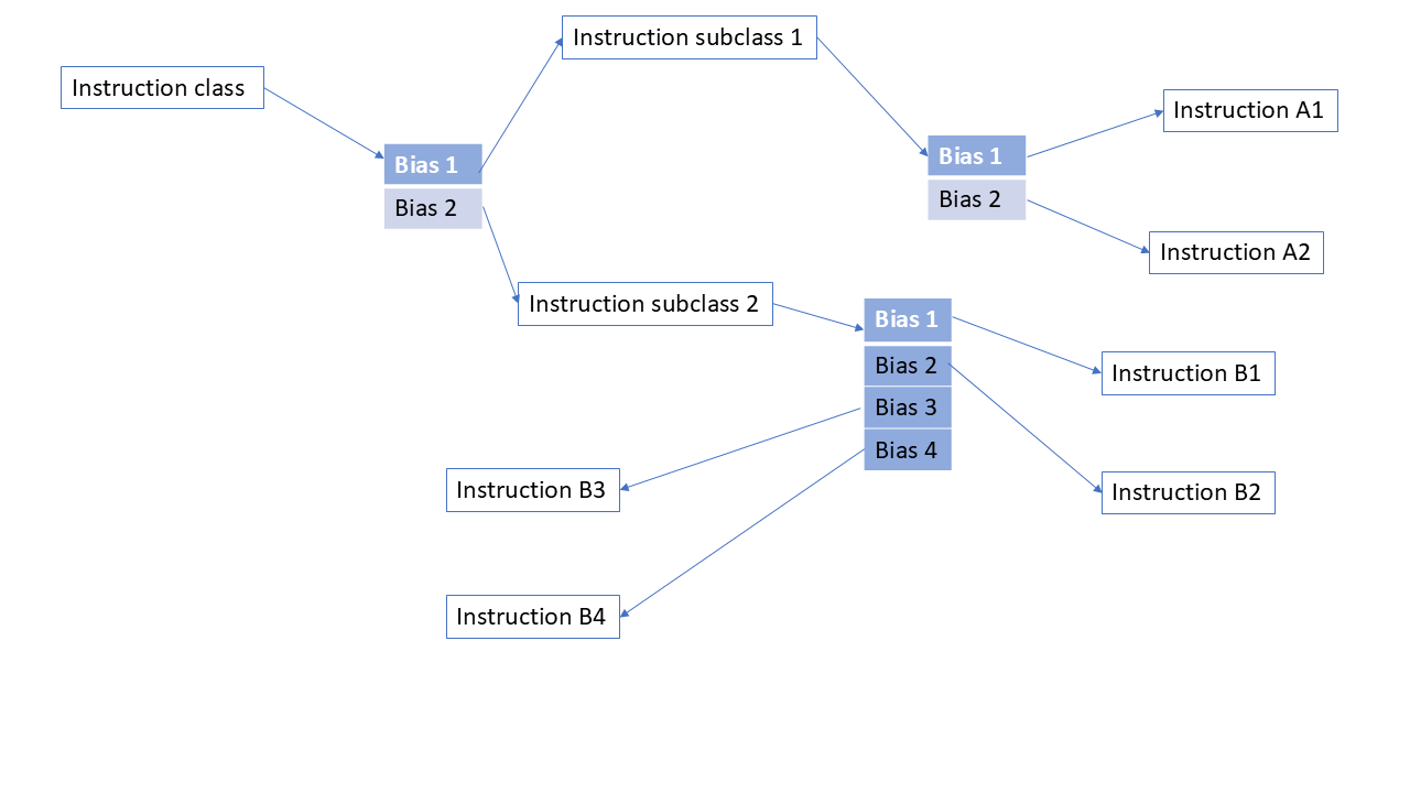

Overview of Bias Tree
The bias tree functions as a mechanism to randomly determine the order of SMC calls directed to TF-A. Here is an example.
Bias Tree Example Figure 2: Bias Tree Example
Each SMC call is categorized as in a feature list(i. e. SDEI, TSP…etc) and then could be subcategorized into smaller lists relevant to testing strategy. This grouping allows a user to assert control over which flavors of SMC calls are executed within a given test scenario. In this example we have feature sets corresponding to the different areas of TF-A that can be biased or turned off altogether. This permits very focused testing to very general by altering the bias numbers contained in the tree.
Here is a generalized example bias tree:
